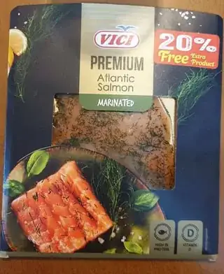

I have bought what looks to be a defrosted raw salmon product in airtight packaging:
Salmon
On the back of the package, it is written that this product can be stored in the fridge for up to a month from the day it was thawed, which is given.
Usually, this is not possible. For example, according to this great answer, raw proteins, specifically fish, can be stored in the fridge for 1–2 days.
I was unable to find more information on what makes this possible. I would like to learn what could make it possible to store uncooked fish in the fridge for up to a month.
I tried searching the internet, but I could not find any information regarding this, including in the Food Safety FAQ here.

I feel I must offer a contradicting opinion to @rumtscho's answer. The product you seem to have is indeed shown in the catalogue at the page of "smoked salmon" products, but note that it is the only one not being named "cold smoked", but "marinated".
And just by the looks of it I assume this is actually Gravlax: raw salmon, preserved by "pickling" in a marinade of lots of salt and sugar (and traditionally dill, but that's only for taste). It will not taste like smoked salmon at all, because it isn't. The marinade will be enough to prevent immediate bacterial growth (all the fluids go out by osmosis, and will turn into a highly saline brine), although in industry there are probably additional substances involved.
Gravlax is also easy to make on your own, in comparison to smoked salmon. Just get a raw salmon filet of good quality, google the right proportions of sugar, salt, and dill, and massage them onto the meat. Then you pack it in foil and leave it in the fridge for a couple of days. (I wouldn't leave it for a month, though.) You'll notice that the meat doesn't really cure, but gets stiffer, somewhat darker in color, and a bit "glassy".

    Thanks, I was able to find more information on the shelf life of gravlax here: https://medcraveonline.com/JAMB/effect-of-fillet-thickness-on-quality-and-shelf-life-of-gravlax-salmon.html – hb20007 Feb 14 '21 at 10:41
  • "it may be extrapolated that the shelf life of gravlax should be longer than 45 days". Wow, that is surprising. – phipsgabler Feb 14 '21 at 11:26
Your salmon is not raw, it is smoked. This is a common conservation technique, and it is the reason why your fish has a long shelf life. The packaging has nothing to do with it.
You can confirm that this specific product is smoked by looking it up in the producer's catalogue, https://www.yumpu.com/en/document/read/63286903/vici-cataolog-en-2020-2021-web - you have to click through to page 23, Smoked salmon (vacuum packed).
The only packaging method that can prolong shelf life of meat and fish that I am aware of is packaging in oxygen-poor atmosphere. If done properly (which is not possible in a home kitchen), it can give you a few additional days of unopened shelf life, but not a whole month. It is unlikely to have been used for smoked fish.

  • "Your salmon is not raw" Are you sure? I found this on Wikipedia: "Cold smoking does not cook the fish" (https://en.wikipedia.org/wiki/Smoked_salmon) – hb20007 Feb 13 '21 at 21:17
    It is not cooked, it's smoked. That's a third state beside raw and cooked. – rumtscho Feb 13 '21 at 21:19
  • Thanks for identifying that smoking is one method that can make such long shelf lives possible. I was able to find more information on that in these links: https://www.doesitgobad.com/does-smoked-salmon-go-bad/ https://www.sciencedirect.com/science/article/abs/pii/S0308814604000317 – hb20007 Feb 14 '21 at 10:35
