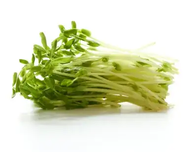

I used this kind of pea sprouts:
Kind Organics pea shoots
First I wash and soak them in salt water for 15 mins. I know that I mustn't overcook these pea shoots. 2nd I turn my stainless steel pan to high heat. 3rd I add oil and Shaoxing wine. 4th I add the pea shoots to the pan, and stir fry for under 30 seconds.
But they're too stiff/starchy to even chew. When I chew them, they turn into lumps that I can't swallow.
Is the kind of sprouts the problem? Are another kind of sprouts sold in Hong Kong?

I don't make the Hong Kong recipe, but I often cook Thai-style pea shoots in the spring. And for that matter I often made them when I lived in California, so origin is not your problem.
One thing I did find is that there's a huge difference in pea shoots based on age. Tiny, 3-day old pea shoots, also called "pea sprouts", are the kind you want to flash-fry:
young snow pea shoots
Pea shoots that are a bit older, like a week or two old are also eaten:
older curly pea shoots
However, these are a lot more fibrous, and need to be blanched before frying. I don't know what you bought, but it really sounds like you got older pea shoots. Species might also make a difference; the ones that Asian markets sell are usually snow pea shoots. If you got some other kind of pea shoot, like English peas, it's possible that those are also more fibrous.
