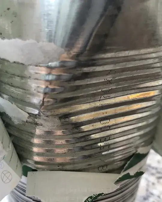

Edit, as I had a dented can at hand:
Under normal circumstances, I would probably have left this can at the store. But thanks to the recent wave of panic buying, a family member decided a dented can was better than none.
You can see that the edge of the dent doesn’t affect the seams, so no problem with leakage, and no subsequent food safety issues:
exterior

Still, this was the can I decided to pull first from the pantry, only a week or so after it was bought. I don’t know when the damage happened, though. If I had noticed anything beyond a shape change, I would have discarded the whole can and used another.
