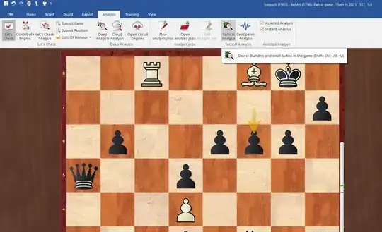

I don't have ChessBase 13, but in ChessBase 16 you simply go to the "Analysis" tab at the top and select either "Tactical Analysis" (for blunders) or "Centipawn Analysis" (for best engine moves).

New board, paste your game in, click analysis tab, click "Let's Check Analysis" (third button from left at the top). Choose the options (try each one if you don't know what they do), and start.
Actually there is a way (but imperfect) to analyse full games in ChessBase, using the Let's Check feature.
  1. Open your game
  2. Click on the analysis tab and enable Let's Check.
  3. Click on Let's Check analysis, and choose for example Standard Analysis (in advanced settings, you can set the analysis time per move). If a given move has already been analyzed by other users, ChessBase will just retrieve the analysis and no calculations are made. If not, it will use your own engine.
