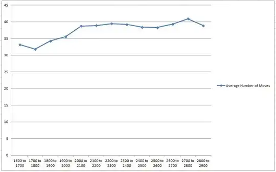

Looking at the actual results, average game length was a bit of a surprise:
Average number of moves by rating group
The sub-2000 rating groups all had significantly shorter games than the higher groups. This may well be explained by the possibility that they were playing stronger opponents (see the average rating, above), and that they were defeated in fewer moves. This seems to go against the slightly shorter games played by the top rating group, although that may be contributed to a smaller sample size.

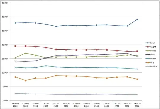

The relatively large differences in average game length meant that providing the frequency of moving a certain piece, rather than the total number of times a piece is moved, is perhaps the more fair comparison. Calculating the frequencies results in the following graph:
Move frequencies by piece
The following trends seem to be present:
  • The frequency of knight moves seems to trend slightly downwards with rating.
  • Bishop moves trend downwards until about 2000, then slowly trend upwards.
  • Rook moves trend sharply upward at roughly the same point, and stay more frequent than Bishop moves in high-level play.
  • Pawn moves seem to trend slightly downwards with increased rating. A large exception is the top category, 2800 to 2900. This brings us to the next point:
  • The top rating category provides outliers or counter-trends in quite a number of measurements. This may be explained in a variety of ways - 1) the sample size is fairly low at 363, not tiny, but 10% of the next smallest sample size included. 2) Since they are at the top of the ratings groups, they never play "stronger" opponents than themselves. 3) Or simply at this level, their play style has transcended the levels below them. My guess would be a combination of 1) and 2).
  • The differences in queen moves and castling moves is very small without any real trends, other than a tiny trend downwards in both cases.
  • The frequency of king moves has some of the largest differences. No clear trend is visible, and it seems to change direction 3 or 4 times.

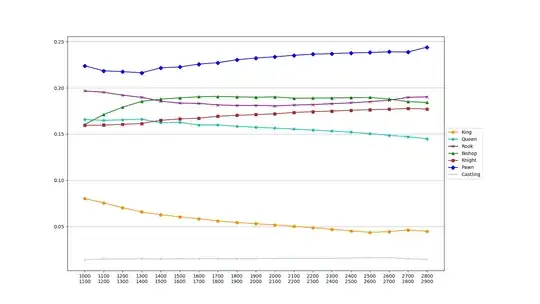

I wanted to remove effects of the early opening and the endgame from the analysis. So, I did a similar analysis as Daniel B, but I only used moves 10 to 29 (inclusively). Here are the results. Move frequencies in the middle game by Elo rating
Many trends are visible in this chart.
  • King moves get less frequent the better the player.
  • Queen moves get less frequent the better the player.
  • Rook moves are more frequent for bad players, but plateau around Elo 2000 and the trend upwards again.
  • Bishop moves are less frequent for bad players, but plateau from 1500 to 2000 and then tend to trend downwards again.
  • Knight moves get more frequent for better players.
  • Pawn moves get more frequent for better players.
  • As for castling, there seems to be a trend for good players to castle more, plateauing at Elo 2700, and then a sharp downwards trend for the elite players with Elo bigger than 2700.
Some technical notes:
I did my analysis on the Rebel 13 Dataset which contains 3456762 games. Some data cleanup was needed for me to parse everything (in particular, I had to remove non-ASCII characters). I only analyzed games where the Elo of both players was given. This resulted in 2375013 games with a total of 84909433 plies used.
