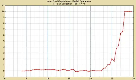

Though one fun variant you can try with an engine at home: Why not extend your engine-evaluation method to visually observe a player's quality/performance via evaluation graphs? In other words, take engine evaluation scores per move and plot them (some free software like SCID does this for you) over the moves.

For a final comparison, a 1911 Grandmaster game would look like this:
No comments necessary here :) These guys really don't make many mistakes, do they?
If you could devise your own heuristic for mapping the slopes + scale of an evaluation graph to player skill/performance, perhaps this is one way to go? :)
