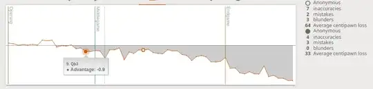

I have trouble seeing what fundamental mistakes I made during this FIDE rated game I played today. I played as white. The game was analyzed without an engine with people at the tournament were we discussed various variations and what me and my opponent thought when doing certain moves. This was a 90min + 15sec increment game which lasted around 3 hours. When playing such long game I believe that one should and could find something beneficial out of these games since these will truly reflect my strengths and weaknesses due to the long time limit. However, I have trouble finding something useful out of this game. I have trouble learning something from it. After the analysis with the people at the tournament I came home and started Stockfish to analyze further. I noticed and understood the blunders, mistakes and inaccuracies that Stockfish pointed out but these seemed to me very specific to this game which is why I am asking for help on this site now.
Do any of you see something more general which is not specific to this game that I could dig more into and improve?
I was very comfortable with the game and felt that it went well until very late in the game were I notice that black has advantage which Stockfish apparently shows that it has been slightly piled up almost the whole game without my notice.
I'm guessing someone will point out the light-squared bishop. I know and knew my light-squared bishop was a really bad piece this game and I had a plan which was in progress to move it to e6.
This was my first FIDE rated match and hence I have no rating.

Presumably you were hoping to play a London system, but your opponent tricked you out of it and you found yourself playing a Benoni where you did not find a plan. You did not have to play d5.
It was already a small mistake to recapture with the Knight on move 6. Maybe you were feeling nervous because it was your first rated game and so you felt inclined to simplify by trading pieces, but if you want to take advantage of having White you don't want to exchange pieces without some specific purpose like leaving your opponent with a bad Bishop. After the trade, you chance of an opening advantage has decreased, but your position is still quite OK.
I don't like 9. Qb3. You are not thinking about how to organize your army. That is a reasonable square for your Queen, but she does not cooperate with anybody else. On d2 she also protects the b2 pawn, and lines up for the typical Bh6 manoeuver later in the game.
You do not display awareness that in Benoni-type position Black can get strong play on the e-file and your e4 pawn will be vulnerable. You manage to avoid losing it but you end up with rather ineffective pieces. Your opponent might have been more ambitious and played 13...Qh4, forcing the weakening move g3. Bearing this in mind I think that 10. Nf3, which looks natural, was an inaccuracy. I would prefer 10. Bd3 to be followed by f3 and Ne2.
On move 16 I think you should recapture with the Bishop. After capturing with the pawn the pawn itself is a weakness and it obstructs the Bishop.
Although others have noted correctly that you traded too many pieces, it was not a mistake to take the Knight on e5. By now, you are not playing for an advantage, you are struggling to survive in an inferior position. That Knight is a strong piece and should remove it.
You are not in real danger of losing, though, until 24.Rh3. I can see no motive for this move, unless you felt you were building for some sort of attack, but there is nothing at all to support that. Black's excellent moves Q-g5-f4 caught you flat-footed and will make you remember that although opposite-colored Bishops may be drawish in the ending, they can lead to very one-sided middle games. Black plays this ending very well. Look at the position after move 26 and remember when YOU had doubled Rooks on the f-file.
In spite of this inauspicious start I hope that you will have many satisfying experiences of tournament chess. In this game you failed to organise your men into a team who could formulate a plan. Later you allowed yourself to to led astray by a mirage having no substance. For people in your situation I recommend reading Simple Chess by Michael Stean. Here is a quote from the publisher.

Your biggest strategic mistake is that you traded too many pieces in a Benoni structure. Black has less space and has several pieces that need to route through a limited number of squares (primarily d7, e5, and f6). By trading pieces you remove the burden for them.

As what @cleveland has mentioned, you traded way too many pieces in a Benoni structured opening. Especially when black bishop is on e5 on move 19, your pieces are going to have a hard time defending your king, especially with your black bishop off the board, that h2 square is a big weakness.
On move 28, when the pawn moved to g4, its nearly lost for white since you cant really move the bishop. Using your rook to pin that pawn to the king does not really help as the h pawn is coming next, so tactical blunder to lift your rook and let the black queen on the extremely dangerous f4 square, as it controls threatens mate on the both the h2, f1 and c1 square on move 25, which later lead to your resign after Qc1+.

As usual people have not read the OP and started analyzing stuff. Let me try my luck. The lesson I think you can learn from this game -- and please do not take this lightly -- is to be patient, to curb the urge to do something, something drastic, something forceful. This unfortunately is the result of how chess games are presented in articles, books and videos. (They choose the most brilliant games with lots of action and glorify forcing tactical moves while brushing over the build-up moves.)
It is obvious that you did not know the opening and also missed rather easy continuations like when Rook comes to e file and piles up on e4. But again my point is not the details. As you said it is not even just the game moves but what you can learn. So, let me repeat you can learn to keep calm and hold on to your position. Let me give examples of where your moves shouted "I am moving this becasue I have to do something, I have to make a threat." Let's go back to after Ne5. Ok, Black has centralized a N but is your position that bad? No. Simply retreat your Bishop, say to c2. If Ng4 then Qg3 and there is no check on f2 while you pressure d6 now. Later your Rf3 idea and doubling. Why?! You know there is no real threat and after Rf8 everything backfires. Do you not know it? You do! It is just that urge to do something. Rh3. Why?! What are you thretening?! Nothing. You can see it but you play it anyway, why? Because of I must do something attitude.
Maybe ask yourself: If I keep the status quo, what is my opponent going to do anyway? What are my good point in my position? Let me keep them. Let me not move a piece that is already doing some job.
This if you take seriously can get you to a lot of places. On more practical side, I have made for myself a list of "When in doubt, [do this!]". You can do one for yourself. Some items from my list that would apply to this game are: when in doubt, play in the center (centralize your pieces. For example after Rd1 your pieces stand strong and central, except for the queen. maybe think about a new home for the queen. Also this would have avoided Rh3 idea.) When is doubt, develop your pieces. This prevents me from (often premature) adventures in the opening.
