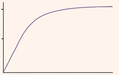

I didn't do the experiment but I think it should be something like enter image description here
As @SmallChess said in his answer: required computational power grows exponentially and at a certain depth it would be just way too big.
for simpler position however it's not the case because the engine would've explored all the possibilities before reaching its full capacity (ie: maximum depth)
MrMaxPayne
  • 469
  • The graph seems about right (assuming it is strenght increase vs resource increase). For simple positions it does not help to have more compute, but for complex positions it can carry you across the tipping point, so I would leave specific positions out of the discussion. – Dennis Jaheruddin Apr 29 '19 at 14:03
