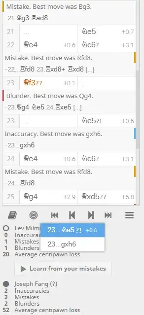

Lichess has an excellent import tool with computer aided analysis.
After uploading a game and analyzing with Stockfish, you can download an annotated PGN of the game. It adds alternate lines and annotated symbols (?! for inaccuracy, ?? for blunder, etc.)
Computer analysis In the PGN, move 23. Qf3 looks like: 23. Qf3?? { (3.13 → 0.10) Blunder. Best move was Qg4. }
Here's an example game I uploaded and analyzed. Use the tabs/links below the game "FEN & PGN" > "Download Annotated" to export the annotated PGN.
Image showing link to download
