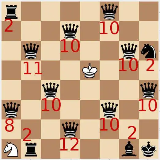

20
Anthony Stewart Mackay Dickens found another solution, also with 105 mating moves, but with only 17 units in the diagram (16 white and the black king):
[title "Anthony Stewart Mackay Dickens, The Problemist, Jan 1970. 105 mates"]
[fen "2Q1Q3/2Q4Q/Q4Q2/3k4/Q5Q1/1R6/B1NBQ3/K2R1N2 w - - 0 1"]
This may be found here on PDB.
Black's last move must have been ...Kc5-d5 following Qxc7+.
Rosie F
  • 6,305
  • 36
The following version has 99 threats none of which is a discovered check. It is possibly the best under that additional requirement.
I made it as an answer to the same question asked on Puzzling SE.
Arnaud Mortier
  • 223
