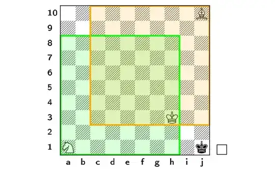

There are obviously many forced wins on any boards where M and N are at least 8 (including M or N or both infinite), so long as there is a corner of the same colour as the bishop's square. enter image description here
If the pieces are all in the yellow tinted sub-board and the black king cannot escape the d10-j4-j10 triangle, the position is also won on the full board, because such positions can be (optimally) won on that sub-board without letting the black king escape the triangle. Similar goes for the green sub-board. The same applies to an MxN board.
But the won positions are by no means restricted to such positions. In the position shown, for example, White can mate in at most 33 moves against any Black defence. There is, of course, a significant percentage of similar positions.
