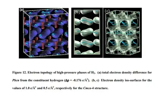

High-pressure studies of hydrogen typically employ a diamond anvil cell (DAC) made of two diamonds holding a few-micrometer-thick gasket containing a tiny sample of hydrogen.
These are some more images I could found of hydrogen at high pressures, but I do not think any of them are like red oxygen.
hydrogenhydrogen

Hydrogen forms similar clusters as cations (here). Some do not even need high pressure. The trihydrogen cation, with a triangular structure resembling an aromatic cyclopropenyl cation ring, is found in interstellar space and some planetary atmospheres, and the six-atom cation with its peculiar "turnstile" strcture (two triangles joined vertex to vertex and twisted 90 degrees from each other) is observed in solid hydrogen.
