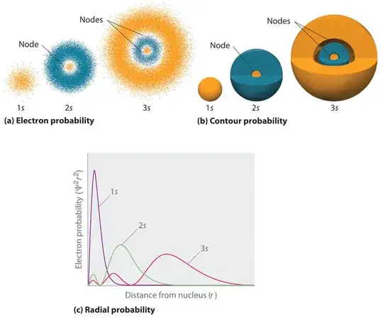

2. The difference between radial and angular nodes
Radial nodes are nodes inside the orbital lobes as far as I can understand. Its easiest to understand by looking at the $s$-orbitals, which can only have radial nodes.
Radial nodes of the s-orbitals
