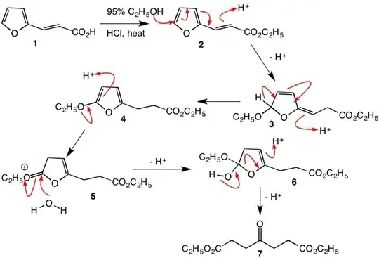

This commentary may be a bit late in the game but some historical perspective may be appreciated. This mechanism question was around when I was a graduate student in the 1960's. The reaction was reported in 1877 by Marckwald.1 He conducted the reaction in 95% ethanol (water present) in the presence of HCl. The diacid of ketodiester 7 was formed by saponification and its composition was confirmed by combustion analysis. The mechanism is no different with methanol and unless methanol is scrupulously dried, the keteneacetal mechanism will not prevail nor will a [1,5]-hydride shift survive. Another point about the mechanisms provided thus far is that enols of ketones and esters, if so regenerated, rapidly tautomerize.
The reaction is catalytic in HCl. Esterification can be effected at any stage of the process, but here, it has been accomplished for convenience in the first step (1 ---> 2). The sequence 2 ---> 4 is a redox reaction in that the double bond is reduced to an alkane while C5 of the furan is oxidized, all through the aegis of a proton. Furans bearing α-alkoxy groups are highly susceptible to acid hydrolysis. Protonation at the β-position leads to facile introduction of water (4 ---> 6). The enol ether 6 is readily protonated causing collapse to Marckwald's keto diester 7. To distinguish between the mechanism presented here and the keteneacetal mechanism presented above, workup in the presence of H2O18 while the reaction mixture is still acidic, will incorporate O18 into the ester carbonyl by rapid deuterolysis of the keteneacetal but not into the esters by the mechanism presented here. Incorporation of O18 into an ester is expected to be much slower than into a keteneacetal.
  1. Marckwald, W. Chemische Berichte, 1877, 20, 2811. DOI: 10.1002/cber.188702002140
