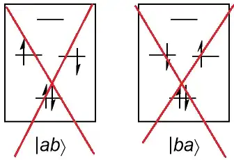

You also wrote that "the singlet state will be doubly degenerate". However, in the case where both electrons are in different orbitals, there is only one possible spatial wavefunction, due to the quantum mechanical requirement of indistinguishability. (As we will see in the group theoretical treatment, there is actually no doubly degenerate case, not even when the electrons are paired in the same orbital.)
If I label the two SOMOs above as $\ket{a}$ and $\ket{b}$ then the combination $\ket{ab}$ is not a valid spatial wavefunction. Neither is $\ket{ba}$ a valid wavefunction.
Inapplicability of the orbital picture
You have to take linear combinations of these two states, such that your spatial wavefunction is symmetric with respect to interchange of the two electrons. In this case the appropriate combination is
$$2^{-1/2}(\ket{ab} + \ket{ba}) \qquad \mathrm{{}^1B_{2g}}$$
There are two more possible symmetric wavefunctions:
$$2^{-1/2}(\ket{aa} + \ket{bb}) \qquad \mathrm{{}^1A_{1g}}$$ $$2^{-1/2}(\ket{aa} - \ket{bb}) \qquad \mathrm{{}^1B_{1g}}$$
(Simply based on the requirement for indistinguishability, one might expect $\ket{aa}$ and $\ket{bb}$ to be admissible states. However, this is not true. If anybody is interested to know more, please feel free to ask a new question.) The orbital picture is actually woefully inadequate at dealing with quantum mechanical descriptions of bonding. However, Voter and Goddard tried to make it work out, by adding and subtracting electron configurations:1
