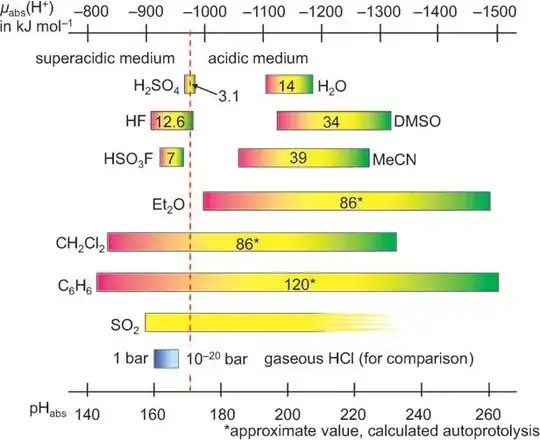

Notice also that not only does the range of $\mathrm{pH}$s change in each solvent, but there is no direct relationship between the values of pH between different solvents; formic acid in ammonia would behave as a strong acid and as such a $\pu{1 M}$ solution in ammonia would have a pH close to 0, but formic acid is actually a base in liquid hydrogen sulfate, and as such a $\pu{1 M}$ solution would have a pH above 1.5. An approximate comparison between the pH ranges and their relative positions in different solvents can be found in the figure below, from A Unified pH Scale for All Phases.
