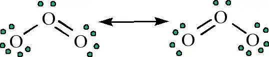

Apart from hydronium ion $\ce{H3O+}$, there are some other molecules or ions which possess three oxygen bonds. All pictures taken from Wikipedia
  1. Carbon monoxide
  1. Ozone
