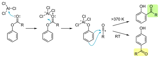

fries rearrangement
(Ref.)
So can you explain the methods (at least the most used) to confirm a mechanism? I am aware that "confirm" does not mean that we are 100% sure, but rather that it is simply the best we have found so far.

For your specific reaction, what do we think the rate-determining step is? Probably addition into the acylium? You could try to capture the acylium intermediate.
You could run the reaction with reactants that have two labelled oxygens and reactants that have no labelled oxygens. Do they mix? If not, it's fully intramolecular. Otherwise, there's an intermolecular component and the mechanism as written is incomplete.
