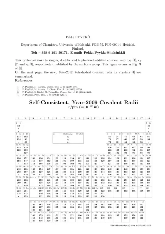

To extend on Philipp's excellent answer, I'd like to offer some advice on judging bond orders. Pekka Pyykkö and Michiko Atsumi published covalent (single-, double-, triple-) bond radii for (almost) the entire periodic table in Chem. Eur. J. 2009, 15, 12770-12779. It is summarised in figure 3. These are obtained from experimental or theoretical data. The figure itself can be found on Pyykkö's homepage as a pdf-file. This version has been extended to include tetrahedral covalent radii. I include a screenshot for reference.
covalent element radii
Another interesting and comprehensive publication for sizes of atoms is the list of Van der Waals radii of elements by S. S. Batsanov published in Inorg. Mat. 2001, 37 (9), 871-885. A mirror of the publisher's pdf can be found here. This is probably also a good starting point for deciding the default size of your atoms. Additionally it might help you identify weak interactions.
