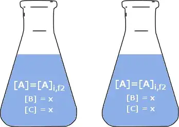

Suppose that I am running the reaction $\ce{A ->B +C}$ in two separate vessels, flask 1 and flask 2, each with a different concentration of $\ce{A}$. We'll say that flask 1 is more concentrated. If you agree that the initial rate is given by $\text{rate}_\mathrm{i} = k[\ce{A}]_\mathrm{i}$, then it follows that for each the initial rate is $\text{rate}_{i,fl1} = k[\ce{A}]_{i, fl1}$ and $\text{rate}_{i,fl2} = k[\ce{A}]_{i, fl2},$ respectively.
initial reaction conditions
If we were to add something to flask 2, would it change the reaction rate? As long as we didn't add any $\ce{A},$ the rate would be the same. The rate is dependent on $\ce{A}$ but nothing else. So let's add a little bit of $\ce{B}$ and a little bit oc $\ce{C}$. We'll add the same amount of both. Let's call that amount $x$ and set it equal to the difference in concentrations in $\ce{A}$ in the two flasks. $$x=[\ce{A}]_{i,f1}-[\ce{A}]_{i.f2}$$ adjusted initial reaction conditions
Now let's let the reaction in flask 1 proceed until the concentration of $\ce{A}$ is equal to the amount in flask 2. To distinguish the conditions now from the initial conditions, we'll call this time $t=1$ (arbitrary units). By the stoichiometry of the reaction, we know the amount of $\ce{A}$ and $\ce{A}$ will be $\Delta[\ce{A}] = [\ce{A}]_{i,f1}-[\ce{A}]_{i,f2}=x$ There is no perceivable difference between the two flasks, and the reaction rate is thus the same in flask 1 as in flask 2. Because we have chosen arbitrary concentrations, we can abstract it to any concentration. $$\text{rate}_{t=1,f1}=\text{rate}_{i,f2}=k[a\ce{A}]_{i,f2}=k[\ce{A}]$$ final reaction conditions
Finally, we want the instant rate. We do this by decreasing the time interval to an infinitesimal amount. $$\lim_{\Delta t \to 0}\frac{-\Delta[\ce{A}]}{\Delta t}=-\frac{\mathrm{d} [\ce{A}]}{\mathrm{d} t}=k[\ce{A}]$$
