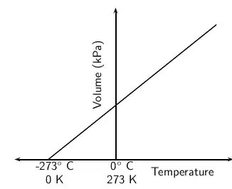

We were dealing with the Third Law of Thermodynamics in class, and my teacher mentioned something that we found quite fascinating:
It is physically impossible to attain a temperature of zero kelvin (absolute zero).
When we pressed him for the rationale behind that, he asked us to take a look at the graph for Charles' Law for gases:
His argument is, that when we extrapolate the graph to -273.15 degrees Celsius (i.e. zero kelvin), the volume drops down all the way to zero; and "since no piece of matter can occupy zero volume ('matter' being something that has mass and occupies space), from the graph for Charles' Law, it is very clear that it is not possible to attain the temperature of zero kelvin".
However, someone else gave me a different explanation: "To reduce the temperature of a body down to zero kelvin, would mean removing all the energy associated with the body. Now, since energy is always associated with mass, if all the energy is removed there won't be any mass left. Hence it isn't possible to attain absolute zero."
Who, if anybody, is correct?
