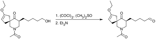

These examples are simple ones in which the molecules easily fit into one class predominantly. More complex molecules may belong to many categories. Organic chemistry calls these categories “Functional Groups”. The ability to predict synthetic outcomes then begins and ends with identifying functional groups within a compound's structure. For example, even though the following compound has a more complex structure, it contains a primary alcohol, which will be oxidized to an aldehyde using the same reagents presented above. We can also be reasonably confident that no unpleasant side reactions will occur.
swern oxidation example on complex structure
If the reagents in the previous reaction had been $\ce{LiAlH4}$ followed by $\ce{H3O+}$, then more than one outcome is possible since more than one functional group in the starting compound will react. Controlling the reaction to give one of the possible outcomes is possible, but requires further careful thought.
