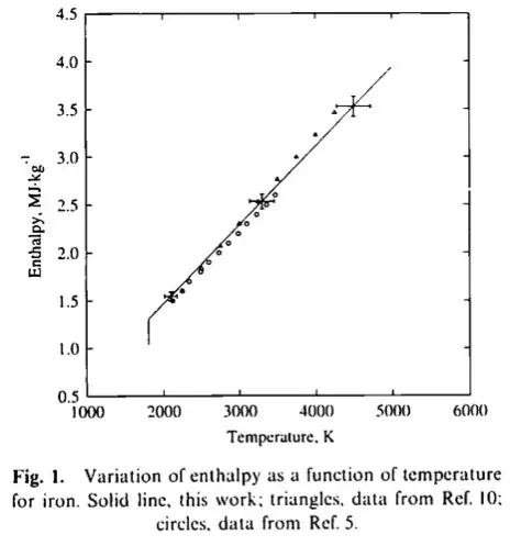

  • “Does an accepted value exist?” and “Is the specific heat of liquid iron temperature-dependent?” — Well, I found a good paper which includes measurements and comparison with previously published values: Thermophysical Properties of Liquid Iron, M. Beutl, G. Pottlacher and H. Jäger, Intl. J. Thermophys., 1994, 15, 1323.
            Fig. 1
which confirms that considering that heat capacity is roughly constant in the 1800–4000 K range. The authors thus extract the constant pressure specific heat capacity as 825 J/kg/K, apparently in reasonable agreement with previous work that they cite:
