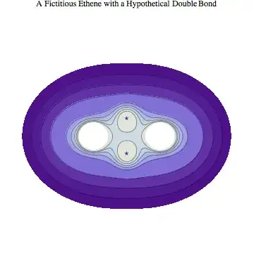

Responding to @michaelm: I might have expected this, if for example, ethene were to have a "double bond" between the carbons:

  • @michielm I think what I am trying to say is, if you look at the electron density, there are no particularly distinguishing characteristics between what we call single, double, and triple! They all look just about the same! – Eric Brown May 06 '13 at 15:21
  • Well yes, but that is if you still try to connect the notion of a double bond to 2 critical points. What I am asking if there is some OTHER characteristic (e.g. maximum value of the electron density) that can be used to distinguish between the classical concepts of single, double and triple bonds – Michiel May 06 '13 at 15:42
  • Unfortunately, no. Arguments about multiple bondedness, from the perspective of QTAIM, are in the eye of the beholder. :-) – Eric Brown May 06 '13 at 15:47
