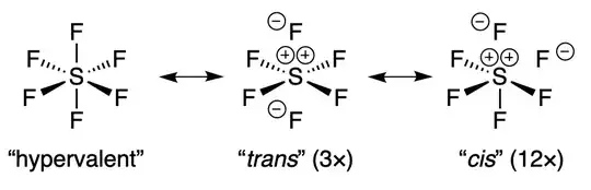

You'll see that, for a total of six $\ce{S-F}$ bonds, we only have four pairs of electrons in bonding MOs. The other two pairs of electrons reside in the $\mathrm{e_g}$ MOs, which are nonbonding and localised on fluorine. If we want to assign a formal charge to sulfur based on this diagram, it would be +2, because there are only actually four bonds. We could perhaps use Lewis diagrams to represent it this way:
Resonance forms of sulfur hexafluoride
The "hypervalent" resonance form contributes rather little and does not rely on invoking d-orbital participation; see Martin's comment on my answer below for greater detail about the resonance contributions. I am guessing that its existence can be mostly attributed to negative hyperconjugation, although I'm not 100% sure on this. The trans and cis resonance forms are not equal, so their contribution is not the same, but the contribution from each individual trans resonance form has to be the same by symmetry. Overall, the six fluorines in $\ce{SF6}$ have to be equivalent by the octahedral symmetry of the molecule. You could run a $\ce{^19F}$ NMR of the compound and it should only give you one peak.
(An alternative way of looking at it is that two of the $\ce{S-F}$ bonds are "true" 2c2e bonds, and that the other four $\ce{S-F}$ "bonds" are in fact just a couple of 3c4e bonds, but I won't go into that. For more information on multi-centre bonds, this article is a nice introduction: J. Chem. Educ. 1998, 75, 910; see also refs. 12 and 13 in that article.)
