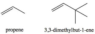

How does the number of hyperconjugates affect the $\ce{C=C}$ bond length in the compounds propene and 3,3-dimethylbut-1-ene?
Structures
In general, is bond length directly or inversely proportional to the number of hyperconjugates?

    Have a look here for a detailed explanation on how hyperconjugation works on a frontier-orbital level. In propene and 3,3-dimethylbut-1-ene you have 3 bonds that can take part in hyperconjugation: in propene it's the 3 $\ce{C-H}$ bonds and in the other compound it's the 3 $\ce{C-C}$ bonds. So, the premise of your question seems to be wrong: The number of "hyperconjugates" is the same, only their types differ. Concentrating on the type, I would say the $\ce{C-C}$ bonds should be a bit more effective at hyperconjugation than the $\ce{C-H}$ bonds. – Philipp Nov 22 '15 at 13:40
The higher the number of alpha hydrogens present in a molecule, the more resonance there will be which will decrease the bond order which was earlier 2, thus decreasing its strength and increasing its length.

Because of hyperconjugation, C2-C3 single bond in propene acquires some double bond character ans hence is little shorter (1.49 Å) than the normal C-C single bond length (1.54 Å).
However in 3,3-dimethyl-but-1-ene there are no alpha hydrogens to operate the hyperconjugation effect and hence the C2-C3 single bond is not affected.enter image description hereenter image description here

It directly depends on the bond order. Because bond order=(number of covalent bonds in that molecule)/(number of resonance structures) Hence ,more the hyperconjugative structures less will be its bond order. As bond order is inversely proportional to bond length,less the bond order more the bond length. Therefore more hyperconjugative structures is directly proportional to bond length. Hence with greater no of alpha hydrogen they will have greater bond length. Hope this helps..
