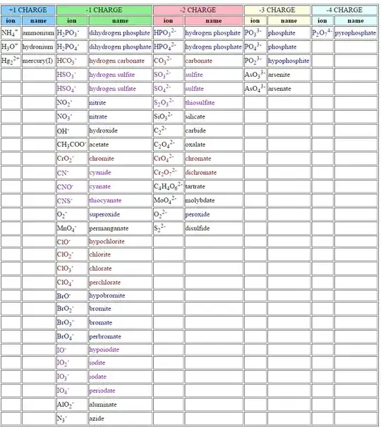

In my Chemistry course, we must memorize a list of common polyatomic ions. Is their an easy way of memorizing ions such as Sulfate $\ce{SO4^2-}$ by looking at just the periodic table. I listed the ones we have to memorize bellow. I know that if they contain oxygen (which is most of them) they usually end in "ate" or "ite." But how do I know how many Oxygen an ion will contain and its charge. My teacher said the only reference table we can use on our test is the Periodic Table of Elements. enter image description here
I have to memorize the name and the formulas of the ions. Any methods will be much appreciated. I guess the real question is their any trends in the periodic table that helps predict the charge and number of oxygens and polyatomic ions will have? So if I have Sulfate for example, Can I predict the formula by looking at Sulfur on the periodic table

    Grouping it by charge is a horribly inefficient way of looking at things. You should look at the individual groups in the Periodic Table and observe the common oxidation states. Then you will notice that they tend to be 2 apart: for example, the halogens have -1 ($\ce{Cl-}$), +1 ($\ce{ClO-}$), +3 ($\ce{ClO2-}$), +5 ($\ce{ClO3-}$), +7 ($\ce{ClO4-}$). This is also true for other elements. Also, there are some exotic species there. I don't understand why you should be forced to memorise them... – orthocresol Oct 18 '15 at 23:36
  • @orthocresol I didn't group it by charge. The table above was the table that my professor gave me of poly-atomic ions we are expected to know. But, I will look into individual groups in the periodic table and look for patterns in the oxidation state. – James Smith Oct 18 '15 at 23:39
    Not that exotic, also hypophosphite is (H2PO2)- 2 hydrogens don't dissotiate. – Mithoron Oct 18 '15 at 23:41
  • @orthocresol Also another way of looking at the samething you said is poly-atomic ions composed of the same atoms in different proportions have the same charge. And if the atom other than oxygen is in an even group the charge is an even number, otherwise it is an odd number – James Smith Oct 18 '15 at 23:55
    @Mithoron His question doesn't ask for help using the periodic table to memorize a list of polyatomic ions. My question is on how I can use the periodic table to memorize a list of poyatmoic ions. – James Smith Oct 19 '15 at 01:10
    Nowhere did I say that you were the one who grouped by charge. I just said it's inefficient. Your teacher gave you a list of ions, including the nonexistent PO3(3-) and PO2(2-), grouped by charge to study. – orthocresol Oct 19 '15 at 07:14
