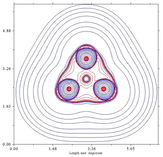

A fast calculation ($\omega$B97X-D/def2-TZVPP) and a subsequent analysis of the isosurface of the Laplacian of the electron density, showed at least the expected "nonlinear", slightly curved bond between the carbon atoms.
Isosurface of the Laplacian of the electron density
Whoever might want to see the electron localization function (ELF), which also shows the bent bonds quite good:
ELF
