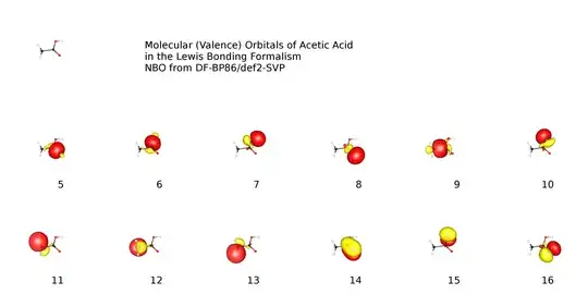

Now we can unitary transform these orbitals to localised orbitals, therefore representing the bonding structure with hybrid orbitals. I am using the Natural Bond Orbital theory for this. The following summary gives the bonds of the carboxyl subunit, the numbers in brackets refer to the orbital number in the picture. Also note, that since these orbitals are no eigenfunctions of the Hamiltonian and they do not have an energy eigenvalue, hence there is no canonical order.
#  (Occupancy)  (Type)    (orbital)  || Contributions below
1. (1.99578)    BD ( 1)   C2 - O1   [6]
            ( 30.48%) C(2) s( 26.60%)  p 2.75( 73.10%)
            ( 69.52%) O(1) s( 35.03%)  p 1.85( 64.91%)
2. (1.99728)    BD ( 1)   C2 - O2   [5]
            ( 33.43%) C2   s( 33.28%)  p 2.00( 66.51%)
            ( 66.57%) O2   s( 42.68%)  p 1.34( 57.24%)
3. (1.99005)    BD ( 2)   C2 - O2   [14]
            ( 31.97%) C2   s(  0.00%)  p 1.00( 99.64%)
            ( 68.03%) O2   s(  0.00%)  p 1.00( 99.87%)
4. (1.98518)    BD ( 1)   O1 - H4   [7]
            ( 74.58%) O1   s( 19.52%)  p 4.12( 80.41%)
            ( 25.42%) H4   s( 99.60%)
5. (1.80107)    BD ( 2)   O1 - H4   [15]
            ( 99.93%) O1   s(  0.00%)  p 1.00( 99.93%)
            (  0.07%) H4   s(  0.00%)  p 1.00(100.00%)
6. (1.97613)    LP ( 1)   O1        [10]
                           s( 45.45%)  p 1.20( 54.52%)
7. (1.97395)    LP ( 1)   O2        [8]
                           s( 57.37%)p 0.74( 42.62%)
8. (1.83220)    LP ( 2)   O2        [16]
                           s(  0.00%)p 1.00( 99.91%)
The total compliance with the Lewis bonding picture is 98.3%. Note the artefact in line 5, which should be a lone pair of oxygen.
From here we can see, that O1 is best described with an sp1.85 contribution towards carbon, an sp4.12 contribution towards hydrogen, an sp1.20 and a p lone pair.
The O2 is best described with an sp2 contribution towards carbon, an π orbital towards carbon, an sp0.74 and a p lone pair.
molecular orbitals of acetic acid in the nbo picture

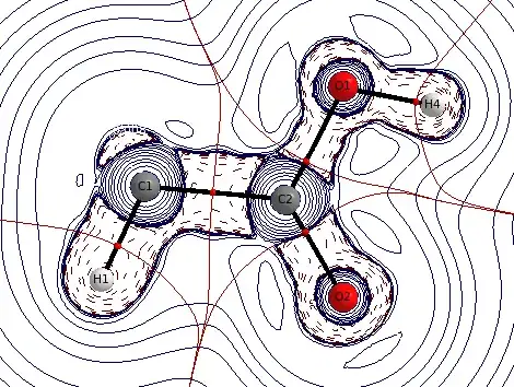

Concerning the intramolecular hydrogen bond, one can analyse the electron density with the Quantum Theory of Atoms in Molecules (QTAIM). This shows that there is no bonding interaction between H4 and O2.
aim plot of acetic acid
(Laplacian distribution, solid blue lines indicate charge depletion $\nabla^2\rho<0$, dashed blue lines indicate charge accumulation $\nabla^2\rho>0$, red spheres are bond critical points, black lines are bond paths, dark red lines are zero flux surfaces. Hydrogens H2 and H3 omitted for clarity.)
One could argue that there is an electrostatic interaction, causing the slightly smaller (105°) CHO angle, but since the H4-O2 distance is only slightly shorter than the sum of the van der Waals radii (H = 1.20 A, O = 1.52 A) in vacuum this might already be a stretch.
