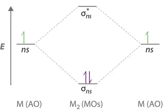

According to molecular orbital theory, disodium should be stable in the gas phase, with a bond order of one. The molecular orbital diagram is the same for all the alkali metals since they all have one valence electron in an $s$ orbital.
NIST chemistry webbook has a small page on disodium and quotes an enthalpy change of formation of $142.07~\mathrm{kJ~mol^{-1}}$ which is moderately endothermic.
This page has a brief discussion of alkali metal dimers and claims that they are all stable in the gas phase, in agreement with the prediction from MO theory.
