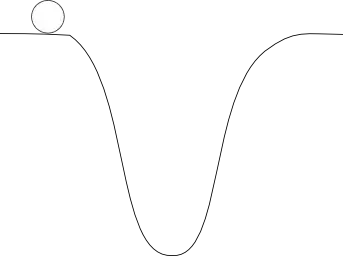

A potential energy surface is a representation of the potential energy of a system as a function of one or more of the other dimensions of a system. Most commonly, the other dimensions are spatial. Potential energy surfaces for chemical systems are usually very complex and hard to draw and visualize. Fortunately, we can make life easier by starting with simple 2-d models, and then extend that understanding to the generalized N-d case.
So, we will start with the easiest type of potential energy to understand: gravitational potential energy. This is easy for us because we live on Earth and are affected by it every day. We have developed an intuitive sense that things tend to move from higher places to lower places, if given the opportunity. For example, if I show you this picture:
You can guess that the rock is eventually going to roll downhill, and eventually come to rest at the bottom of the valley.
However, you also intuitively know that it is not going to move unless something moves it. In other words, it needs some kinetic energy to get going.

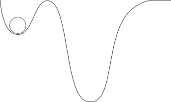

I could make it even harder for the rock to get moving by changing the surface a little bit:
2d potential surface with local minimum
Now it is really obvious that the rock isn't going anywhere until it gains enough kinetic energy to overcome the little hill between the valley it is in, and the deeper valley to the right.
We call the first valley a local minimum in the potential energy surface. In mathematical terms, this means that the first derivative of potential energy with respect to position is zero:
$$\frac{\mathrm dE}{\mathrm dx} = 0$$
and the second derivative is positive:
$$\frac{\mathrm d^2E}{\mathrm dx^2} \gt 0$$
In other words, the slope is zero and the shape is concave up (or convex).
The deeper valley to the right is the global minimum (at least as far as we can tell). It has the same mathematical properties, but the magnitude of the energy is lower – the valley is deeper.
If you put all of this together, (and can tolerate a little anthropomorphization) you could say that the rock wants to get to the global minimum, but whether or not it can get there is determined by the amount of kinetic energy it has.
It needs at least enough kinetic energy to overcome all of the local maxima along the path between its current local minimum and the global minimum.
If it doesn't have enough kinetic energy to move out of its current position, we say that it is kinetically stable or kinetically trapped. If it has reached the global minimum, we say it is thermodynamically stable.
