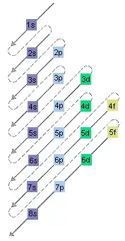

Chromium is one of the 'exceptions to the predicted electron configurations' when applying Madelung's rule for quantum numbers and electron configuration. The 'Aufbau' principle (represented in diagram below) can be used to determine the electron structure of relatively simple atoms, by hand, as long as one remembers the anomalies (such as chromium and copper). The 'anomaly' is typically 'explained' by stating that the a 'half-filled' or 'completely filled' d-subshell is more stable and will therefore happen before 'completely filling' the 4s subshell.
