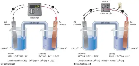

I think this image should make clear the operation of both kinds of cells, the processes that occur at each electrode, and the sign convention.
galvanic versus electrolytic cell
Although it illustrates a specific reaction, you may generalised it to other systems.

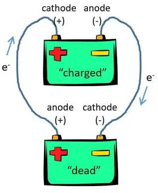

The (+) and (-) refers to the flow of electrons in the power supply. In a galvanic (Voltaic) cell, the cell itself is the power supply. In an electrolytical cell, the cell is attached to an external power supply. So while the designation of anode and cathode is directly linked to the direction of the flow of electrons in a cell, how (+) and (-) relate to anode and cathode depends on whether the reaction goes towards equilibrium or not (in the case of rechargeable batteries, whether you are draining or charging the battery). Depending on the direction of the reaction, anode and cathode labels change, while (+) and (-) labels stay the same.
An example illustrates this. Here are two lead acid batteries connected together in a way where the charged one charges the empty one:
The (+) and (-) label relates to the direction electrons would flow if they are discharging (of course, the dead battery can't discharge further, so you could not tell experimentally). The anode and cathode labels refer to the specific situation. So if you attach a higher voltage power supply to the charged battery instead of the dead battery, you would charge it further. This would reverse the chemical reaction in that battery, and the anode and cathode labels would have to be switched.
In a different scenario, you could take two 12 volt batteries and connect them in series (connect (+) of one with (-) of the other one). This would give you a 24 volt battery, and if you attach a consumer to it, cathode would be (+) and anode would be (-) for both of them.
For the lead acid battery, (+) and (-) never changes, so it is fine to label the electrodes permanently. In a concentration cell, (+) and (-) depends on the concentration of redox species in the two half cells, so you could not label them "with permanent marker".
