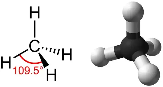

There's a problem with this though, one that mathematicians will be oblivious to, but which chemists will be instinctively aware of.
Anyone not familiar with organic chemistry will observe that the C atoms have four arms branching off at 90° angles within a plane, since that's how they are represented in the diagram.
A chemist though will know that C atom arms aren't all in a plane; they spread themselves out to be equally separated in 3 dimensions. The C is at the centre of a tetrahedron with one arm extending to each of its four corners.
For instance, a methane molecule, CH4 would shape itself as a completely symmetrical tetrahedron:
wikimedia image of methane molecule
In the given propane molecule, the two C atoms at either end have four arms that are symmetrically located in 3 dimensions, again in the form of a tetrahedron.
That means that the 3 attached Hs are all symmetrically equivalent. Rather than forming a T-shape, they are actually arranged in a triangle, whose plane is perpendicular to the diagram. Each of the thee H positions are equivalent and indistinguishable.
So, it matters not which of the 3 Hs at the end gets replaced, in terms of the actual molecule the results will be identical. By convention though, it is the end location that is always used in the diagram, to keep the diagram as symmetric as possible.
As a further exercise, consider the C at the centre of the diagram in the question, whose four arms are attached to two Hs and two Cs. How many distinct ways can these connections be made? Perhaps surprisingly, the answer is that all arrangements will be identical. Attach one of the Hs anywhere. No matter where the second H goes, it will be adjacent to the first. No matter where the two Cs go, each will be adjacent to both of the Hs and to the other C.
