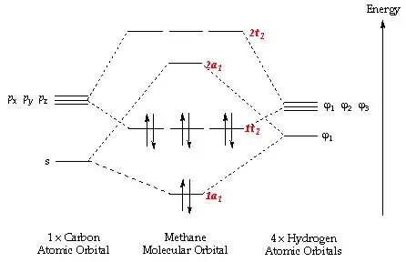

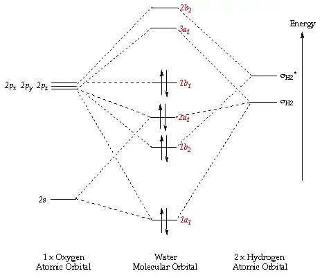

Next I examined an an approach based on MO analysis. Let's examine the MO diagrams for $\ce{HO-H, H2N-H}$ and $\ce{H3C-H}$, they are pictured below.
We see that water has a (roughly) p-hybridized lone pair (the $\ce{1b_1}$ orbital) that is non-bonding. For ammonia, the lone pair is in an (roughly) $\ce{sp^3}$ hybridized orbital (the $\ce{2a_1}$ orbital) that is lower in energy than the non-bonding atomic p-orbitals. In the case of methane, there are no lone pairs and all MOs are bonding (lower in energy than the p AOs).
Now, imagine what would happen to these MOs if we removed a hydrogen atom from each of them and remixed the resultant MOs with themselves (e.g. dimerize $\ce{HO{.},~ H2N{.}~ and~ H3C{.}}$). My (simple) analysis suggests the in forming hydrogen peroxide the $\ce{1b_1}$ orbital would mix and split to form 2 new MOs, one bonding and one (slightly more) antibonding, both filled with 2 electrons, for a net destabilization relative to water. Similarly when we form hydrazine, two $\ce{2a_1}$ orbitals will mix to produce two new MOs, one lower in energy than a non-bonding p AO, and the other either slightly lower or slightly higher (depending on the degree of splitting) than a non-bonding p AO. Energetically speaking, the hydrazine case shouldn't be as destabilized as hydrogen peroxide. Finally, when we form ethane, all orbitals will be more stable than a non-bonding p AO.
This analysis, based on the relative energetic positioning of the lone pairs in these molecules, appears to be in accord with the observed bond strengths of these molecules.
