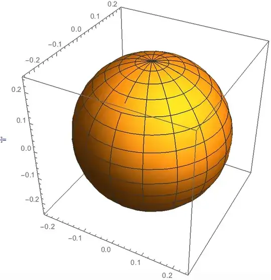

For say an $s$-orbital like l = 0, m = 0. It is trivial to see that the wave function, and consequently $|psi|^2$ is spherically symmetric. i.e. depends only on $r$ because $Y^0_0 = \frac{1}{2\sqrt{ \pi}}$.
Now, let us look at the $p$-orbitals where $l = 1$ and $m$ takes values $-1,0,1$
$$ Y^0_1 = \frac{1}{2} \sqrt{\frac{3}{\pi}} cos \left( \theta \right)$$ $$ Y^{\pm 1}_1 = \mp \frac{1}{2} \sqrt{\frac{3}{\pi}} sin \left( \theta \right)e^{\pm i \phi}$$
Now, clearly $\sum\limits_{j} |Y^j_1|^2 = \frac{3}{4\pi}$ is independent of $\theta$ and $\phi$
The same analysis can be repeated for $d,f$ -orbitals as well. A table of spherical harmonics can be found here
So essentially atoms with electrons in valence $s$-orbitals and/or completely filled or half-filled $p,d,f$ shells would be spherically symmetric.
Now, what if we have something like $2p^1$ type situation. A single $p$-orbital is not spherical. But given that space is isotropic, we have no external fields etc., all the $p$-orbitals corresponding to different $m$ values are essentially the same (degenerate). Nature can't tell the difference, and neither can you when you perform an experiment to measure the "Spherical-ness" of an electron.
This does not mean we are naively taking a superposition of the $p$-orbitals. If you see proof by pictures section, this is clearly not true
Proof by Pictures
Note: The spherical harmonics are complex valued functions, so they are hard to plot, the individual $p$ orbitals conventionally plotted are generated by taking linear combinations of them which are still solutions to the Schrödinger's equation. Given below is $p_z$ orbital, $p_x$ and $p_y$ look the same just are oriented along the $x$ and $y$ axis. enter image description here
A naive sum of $p_x$, $p_y$ and $p_z$ orbitals.
Plot of $\sum\limits_{j} |Y^j_1|^2 $. Remember that observable quantities are related to $|\psi|^2$.
