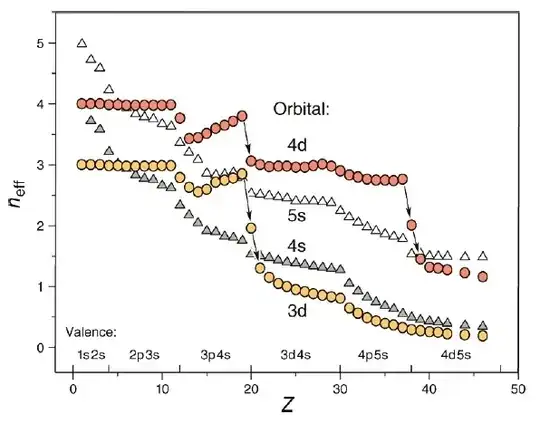

When I was perusing the works of Schwarz on atomic structure, I came across the unfamiliar term of d-orbital collapse.
He describes it as a variation in energetic sequence from group 1 to 3 elements such that the order changes from $\ce{4s < 4p < 3d}$ in $\ce{K}$, $\ce{4s < 3d < 4p}$ in $\ce{Ca}$ and $\ce{3d < 4s < 4p}$ for $\ce{Sc}$ and subsequent elements.
He continues to say "It is the result of the interplay of nuclear attraction, of imperfect shielding by the inner-core electrons, and of angular-momentum dependent centrifugal forces. It explains why 4s becomes occupied in $\ce{K}$ and $\ce{Ca}$ before $\ce{3d}$, but $\ce{3d}$ before $\ce{4s}$ in the transition elements."
Graph taken from "The Full Story of the Electron Configurations of the Transition Elements" J. Chem. Educ., 2010, 87 (4), pp 444–448
He states the orbital energies $ε$ are represented by the effective quantum numbers $$n_\mathrm{eff} = \frac{1}{\left(\frac{\sqrt{|ε|}}{\pu{13.606 eV}}\right)^3}.$$ This seems to imply the orbital energy of $\ce{4s}$ is lower than $\ce{3d}$ for $\ce{K}$ and $\ce{Ca}$ hence the $\ce{4s}$ orbitals are occupied in preference to $\ce{3d}$ in their atoms.

Does Schwarz's d-orbital collapse actually imply 4s orbitals having lower energy than 3d? Is there any way to renconcile the contrasting information presented?
