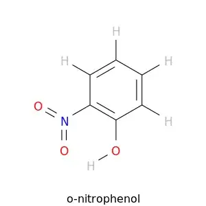

How can we confirm or have a clear idea whether hydrogen bonding is taking place in substituents of cyclic compounds? For example, it takes place in ortho-nitrophenol, but it doesn't take place in ortho-flurophenol despite the fact that the nitro group and the fluorine are present at the same position and both are highly electronegative.

  • Nitro and fluorine are not really similarly placed despite being at the same position. The former has a six-member ring when you make the hydrogen bond, the latter only a five-member ring. Given the constraints involved with placement on an aromatic ring, even in the ortho case, the six-membered ring is easier to form. – Oscar Lanzi Jan 08 '20 at 19:50

For the two molecules you mentioned, I've done the analysis with xtb and Multiwfn.
o-fluorophenol o-nitrophenol
With these two molecules it is still quite simple, because they are flat (mostly at least; they are of course not static). Here is a model of the 3D structures with the hydrogen bond measured. For ortho-fluorophenol it is 2.25 Å and for ortho-nitrophenol it is 1.73 Å. You can see a clear difference already.
H-bond in o-fluorophenol H-bond in o-nitrophenol
And here are the non-covalent interactions from Multiwfn analysis (Option 20, 2, visualised with ChemCraft at contour value 0.2 and in range ±0.05):
NCI in o-fluorophenol NCI in o-nitrophenol
The red coloured blobs correspond to repulsive interactions, while the green and blue coloured values correspond to attractive interactions. As you can see, there is no hydrogen bonding in ortho-fluorophenol, but there is some in o-nitrophenol.
