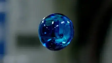

For reference, this is how water looks in the absence of gravity:
Please note: Water is coloured to enhance visibility
