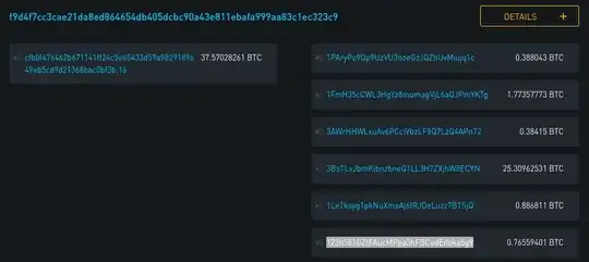

I'm looking into the second tx posted by the asker: fa0dee70658fd00d6d205f673e79e3481cdba57100db576f2a7a308591a1c5e0
It doesn't appear on any explorers. I noticed that all inputs were listed as being vout: 0, e.g. the input list states
  "addressIds": [
    "123h581GZtFAucMPpa3hFBCedEifaka5g9"
  "amount": 76559401,
  "txId": "f9d4f7cc3cae21da8ed864654db405dcbc90a43e811ebafa999aa83c1ec323c9",
  "coinbase": null,
  "voutIndex": 0
for one of the inputs.
However, the unspent was actually the sixth output (vout: 5) when it was created:

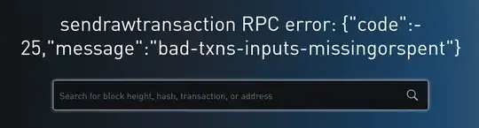

When I put the txhex into https://blockstream.info/testnet/tx/push, it fails with sendrawtransaction RPC error: {"code":-25,"message":"bad-txns-inputs-missingorspent"}.
enter image description here.
The transaction is invalid due to incorrectly specifying the output list position of the UTXO used in the inputs.
