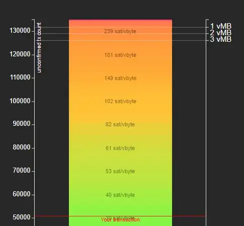

This is how you can visualize your transaction in a pool of other unconfirmed transactions with different fee rates:
mempool
Miners prioritize transactions with higher fee rates from this pool to add in the blocks and thats how transactions are confirmed. Your transaction will stay lower in the pool and less likely to get confirmed until others keep using higher fee rate.
Also there is a limit of 300 MB used by most of the full nodes which might result in lot of low fee rate transactions being dropped from their mempool. Not sure if this will affect your transaction with fee rate: 30 sat/vByte.

  • Fee rate distribution: https://i.imgur.com/sU4Okpp.jpg 30 sat/vByte transactions should confirm by Monday –  Oct 29 '20 at 06:50
