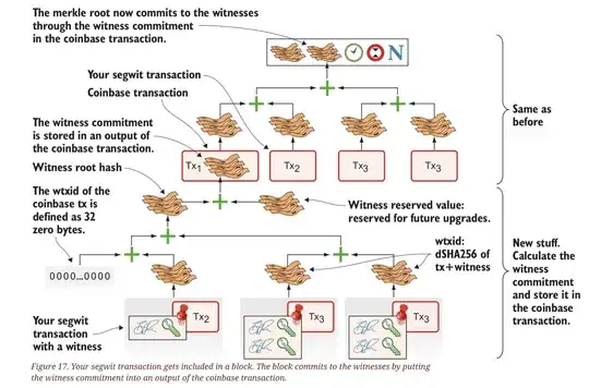

To add to Pieter's answer here is a diagram. The witnesses at the bottom of the Merkle tree are not seen by old nodes that haven't enabled SegWit. Hence the block size limit (1MB) for these old nodes is not breached. It is only new nodes that have enabled SegWit that will see these witnesses and handle blocks that are effectively larger than the previous 1MB block size limit.
grokking bitcoin diagram
This diagram is taken from Kalle Rosenbaum's book Grokking Bitcoin which you can read here for free or purchase here from the publisher Manning.
