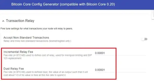

Related options in bitcoin.conf:
incrementalrelayfee : Fee rate (in BTC/kB) used to define cost of relay, used for mempool limiting and BIP 125 replacement.
dustrelayfee : Fee rate (in BTC/kB) used to defined dust, the value of an output such that it will cost about 1/3 of its value in fees at this fee rate to spend it.
related-options
