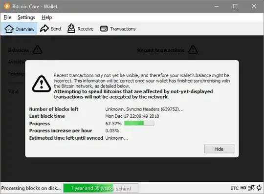

Synchronisation
If the bottom of the main window of your Bictoincore.org wallet looks like this, you need to wait for it to catch up (it is still busy downloading details of recent transactions)
bitcoin-core's status-bar
The icon at bottom right (two arrows moving in a circle) indicates the wallet is busy "catching up".

Checking whether a Bitcoin Core wallet knows about a transaction
In Bitcoin core it is usually obvious if the wallet has not finished synchronisation. You will see a message like this:
Synchronising Warning

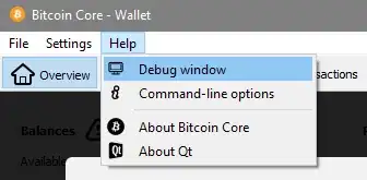

If not you can check from the "Debug Window" in the "Help" menu
Menu
Then you can click the "console" tab and then type command getblockcount at the bottom
