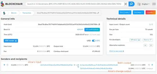

I grabbed a random transaction from blockchair.com to visualize:
transaction with one input and two outputs of which one has a round number amount
If Alice's wallet had not created the change output to itself, Alice would have paid 11,044.… BTC in additional fees. ;)
Note, that I'm simply guessing that the 610 BTC is the recipient output due to the round number, I'm not intimately familiar with this transaction.
