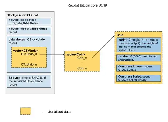

Pieter Wuille gave a great explanation that is easy to follow. Since that posting there was a replacement of CTxInUndo with Coin, does the format still stands for the CBlockUndo record?
  • 4 bytes: network magic (0xf9,0xbe,0xb4,0xd9)
  • 4 bytes: size of the CBlockUndo record (LE32)
  • data_size bytes: CBlockUndo record
  • 32 bytes: double-SHA256 of the serialized CBlockUndo record
CBlockUndo results in a serialized vector of CTxUndo records. Which is right now the serialized vector of Coin records.
And here is the Coin (or at least how I get it right now):
  • varint that is serialized: 2*height (+1 if it was a coinbase output): the height of the block that created the spent UTXO. By the way, is uint32_t{2} the same as (uint32_t)2 in TxInUndoFormatter varint Serialize
  • version dummy value 0: we do not use version anymore but for compatibility using a 0000 or zero value in here
  • CompressedAmount: spent UTXO's nValue
  • CompressedScript: spent UTXO's scriptPubKey

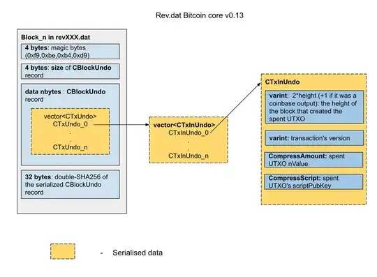

Just for reference, I draw some image of current v0.19 and previous v0.13 versions of rev*.dat file: enter image description here

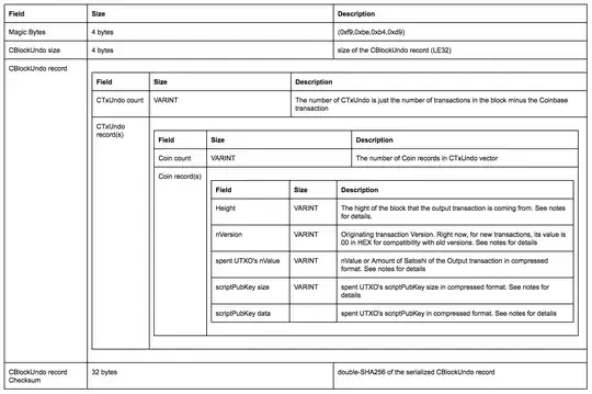

Heigh and Version fields Fields height and version are needed to identify Outputs if they are last spent in the Transaction outputs. In older revxx.dat files, only if Output was last unspent in a Transaction it's height will be there together with it’s Transaction’s Version. If it's a regular Output then the height field will be 0 (00 HEX in Varint format ) and there will be no Version field
In newer revxx.dat files height is written for every Output and the Version field is 0 (00 in HEX) to be backward compatible. I did not check the revxx.dat files myself if it’s so, so please test this note first.
Calculation of Height from the Field Value: To compress the Amount of Statoshis this field uses the following logic: If the amount is 0, output 0 First, divide the amount (in base units) by the largest power of 10 possible; call the exponent e (e is max 9) if e < 9, the last digit of the resulting number cannot be 0; store it as d, and drop it (divide by 10) call the result n output 1 + 10*(9n + d - 1) + e if e==9, we only know the resulting number is not zero, so output 1 + 10(n - 1) + 9 (this is decodable, as d is in [1-9] and e is in [0-9]) Then store it as a VARINT

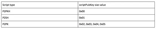

ScriptPubKey size and SriptPubKey fields
Current Bitcoin serialization is using a compressed format to store common types of scripts:
  • Pay to Pubkey Hash (P2PKH) is encoded to – 20 bytes
  • Pay to Script Hash (P2SH) is encoded to – 20 bytes
  • Pay to Pubkey (P2PK) is encoded to – 32 bytes
Other script types are serialized using the general rule shown in the table:
  • scriptPubKey size
  • scriptPubKey data
Where script size is a VARINT field of len(scriptPubKey data) + number of special cases, where the number of special cases is int(6), then goes the regular scriptPubKey data.
The compression algorithm is removing all OP_CODE values from the common types of scripts and leaves only the Key, KeyHash, or ScriptHash intact. Then it is using the field to indicate the type of script in the next field.
P2Pk cases: 0x02, 0x03 identify compressed Public Key and show how which Y coordinate to use to reconstruct the full key. 0x04, 0x05 identify uncompressed Public Key, but the value in the is still in a compressed format and, and the size value shows which Y coordinate to use.
For other script types be sure to keep in mind that is VARINT(len(scriptPubKey size) + int(6))
