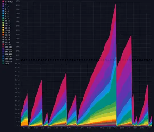

Your transaction paid a fee of 1674 satoshis for 372 bytes, or a fee rate of 4.5 satoshis per byte, which was a reasonable estimate in the past hour (via https://mempool.space/tv):enter image description here

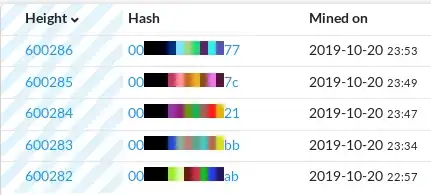

There was just a slow block with #600,283 taking 37 minutes to be found (via https://blockchair.com) and it looks like your transaction would have been exactly in that little blue corner above the dotted line.
Otherwise, four of the last six blocks were not even full, so if not for that slower block, it would have been included in the next block (via https://mempool.space/tv): overview of last six blocks
