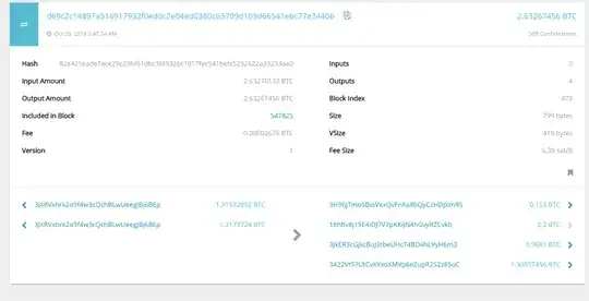

Blockchain.info is simply wrong. While it shows the transaction being unconfirmed, the transaction is actually confirmed: enter image description here
See Smartbit.com.au: https://www.smartbit.com.au/tx/d69c2c14897a516917932f0ed0c2e04ed0380c63709d103d66541e6c77e34406
