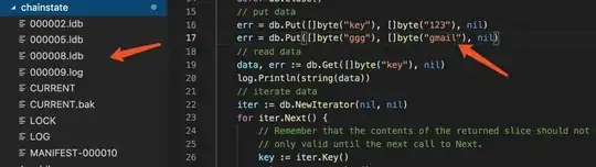

At the moment I try out creating my own leveldb I understand.. The chainstate folder itself is the entry point of the database; all the files within it are just the data.
This is what the data looks like after I put some dummy data

  • @MeshCollider np. :) Actually the 3 questions can be answered by this one. The separation of .ldb files has nothing to do with bitcoin, it's just the way leveldb stores the data. I hope this learning can help save others' time. – lzl124631x Oct 21 '18 at 09:50
