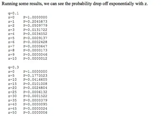

Section 11 presents calculations of the probability of double spending, P(z, q), given an attacker relative hash rate q and a block count z.
Calculations
P(z, q) can only be understood by knowing exactly what z represents. From the Calculations section:
The recipient waits until the transaction has been added to a block and z blocks have been linked after it. He doesn't know the exact amount of progress the attacker has made, but assuming the honest blocks took the average expected time per block, the attacker's potential progress will be a Poisson distribution with expected value... [my emphasis]
Clearly, the transaction has one confirmation. The transaction "has been added to a block" and zero blocks have been linked after it. In other words, the transaction is hosted by the tip of the active chain.
Nevertheless, the probability of this transaction being double-spent is 100%, regardless of the attacker's hash power. In fact, the probability is 100% even with no active attacker.
This contradiction is reinforced by the equation Satoshi gives:
When z = 0, P = 1.0.
What am I missing?
There is at least one answer to this question that claims that z=0 means that the transaction is unconfirmed. That's inconsistent with the paragraph I quoted.
There appears to be an error somewhere in the Calculations section leading to a contradiction. I'm looking for an answer that either points the error out, or explains what I'm misinterpreting.

I believe at least part of the problem is mathematical. Specifically, Satoshi gives the value of λ as:
When z=0, λ=0.
Referring back to Satoshi's original derivation of double-spending probability P(z, q):
λ=0 means that every term is zero, independent of hash rate. In other words, the attacker can never double spend.
This contradicts the "rearranged" form of the equation, which gives a probability of 100% as noted above.
I'm no math specialist, but from what I can tell, the two forms of P(z, q) that Satoshi gives are not equivalent for z=0. In fact, they give the opposite answer:
  • in one case, the attacker always fails, P(z, q) = 0
  • in the other case, the attacker succeeds with 100% probability, P(z, q) = 1.
Either way, the attacker's relative hash rate doesn't factor into the analysis when z=0.

One way to interpret this is that there is, indeed, a mistake.
A more charitable interpretation is that there are two unstated assumptions:
  1. The attacker is performing a Finney-like attack - that is, he has already pre-mined a block before even attempting the transaction. So while z=0 means the honest network has 1 block, so does the attacker.
  2. The attacker wins propagation races. So if there is a leaf attacker block with the double-spending transaction, and a same-height leaf honest block with the original transaction, the attacker's transaction will be accepted.
Together, these give a 100% chance of success for the attacker if there is only 1 confirmation.
In my own paper on the subject, I have explicitly stated the assumption that the attacker already has one block (while removing a different simplifying assumption).

Does z = 0 mean that a transaction hasn't yet been confirmed, or that it has been confirmed but its block hasn't yet been extended?
Z = 0 means that the transaction has not yet been confirmed. The probability is 1 because, under the assumptions made for these calculations, unconfirmed transactions can always be considered insecure and double spendable by the attacker regardless of their hashrate.
